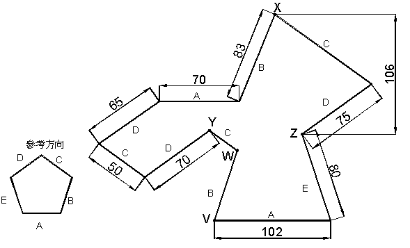

一、试绘出下图并回答下列五个问题(10分,每小题2分,选择题答错倒扣该小题25%)
OCK aspectratio="t" v:ext="edit"> 1. 图形所围成的周长为何? mm
2. X、Y、Z所围成之面积为何?
(A) 4003.3996 (B) 4005.3996 (C) 4002.3996 (D) 4004.3996
3. W、X、Y所围成之周长为何? mm
4. W至点V的直线距离为何?
(A) 66.2398 (B) 66.2198 (C) 66.2498 (D) 66.2298
5. 三角形△VWZ之周长为何? mm

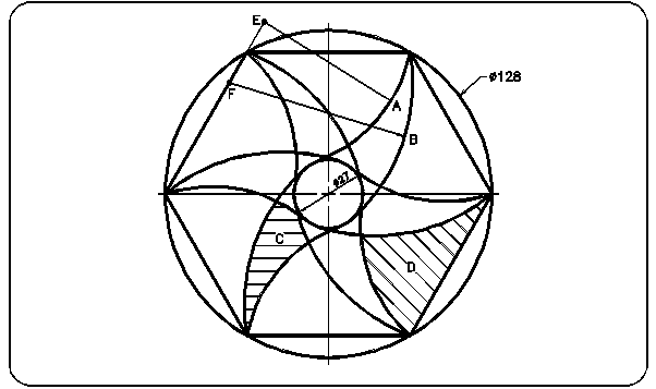

二、试绘出下图并回答下列五个问题(10分,每小题2分,选择题答错倒扣该小题25%)
6. A圆弧的半径值为何?
(A)58.336 (B)58.358 (C)58.325 (D)58.347
7. B圆弧的半径值为何? mm
8. C剖面区域之面积为何?
(A)527.612 (B)527.634 (C)527.601 (D)527.623
9. D剖面区域之面积为何? mm2
10.E点至F点的距离为何? mm
